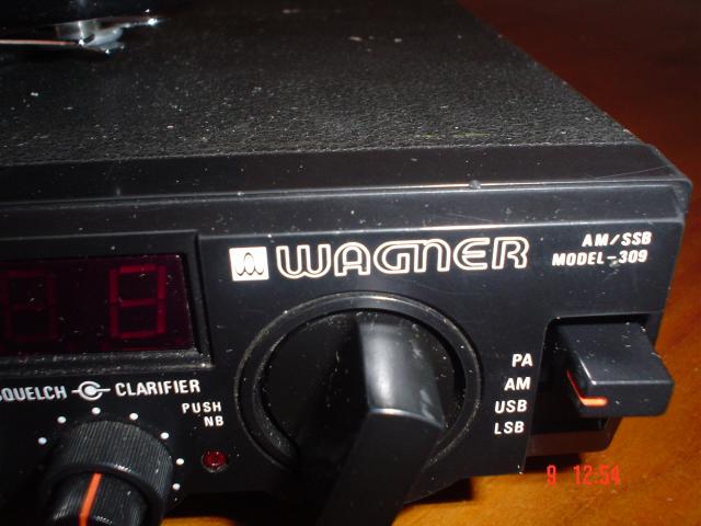

Hi!
I have got some old and broken CB radio - WAGNER from a friend of mine and would like to fix it.
I don't know much about this product (found a few pictures only)
Suzuki 88 - El tema no es válido o ha sido eliminado ... n-consejo/
and can't find anything else about it.
Does anyone have or can tell where can I find schematic or anything about this 27MHz CB AM/SSB WAGNER MODEL-309???
