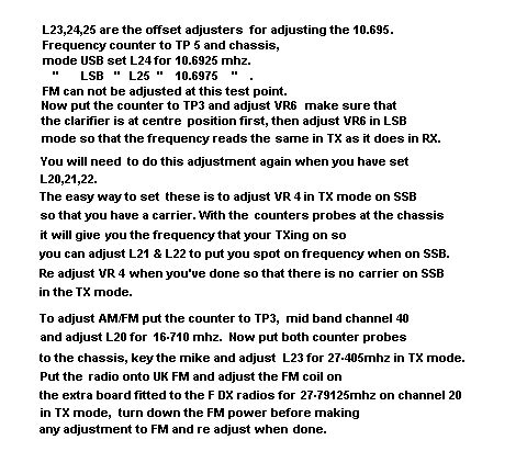

This might help you put it back on frequency but only if you have a 7 digit counter.
ST9 LAYOUT.GIF (10.33 KiB) Viewed 10666 times

oh dear i have a 6 digit counter and i am still not sure dave is it vr 6 or does all these parts need adjusted to bring it back on freq :? many thanks for your help philip

Sorry Philip, you'll need this part as well.
