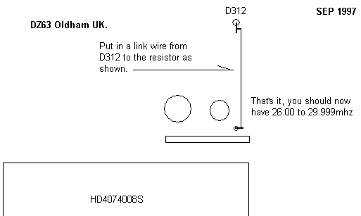

All you need do is put a link as shown in the diagram to open it up.
- 26 to 30.png (7.06 KiB) Viewed 25887 times

Ok thanks Zodiac
There are solder marks on those components, so it probably has been done before.
