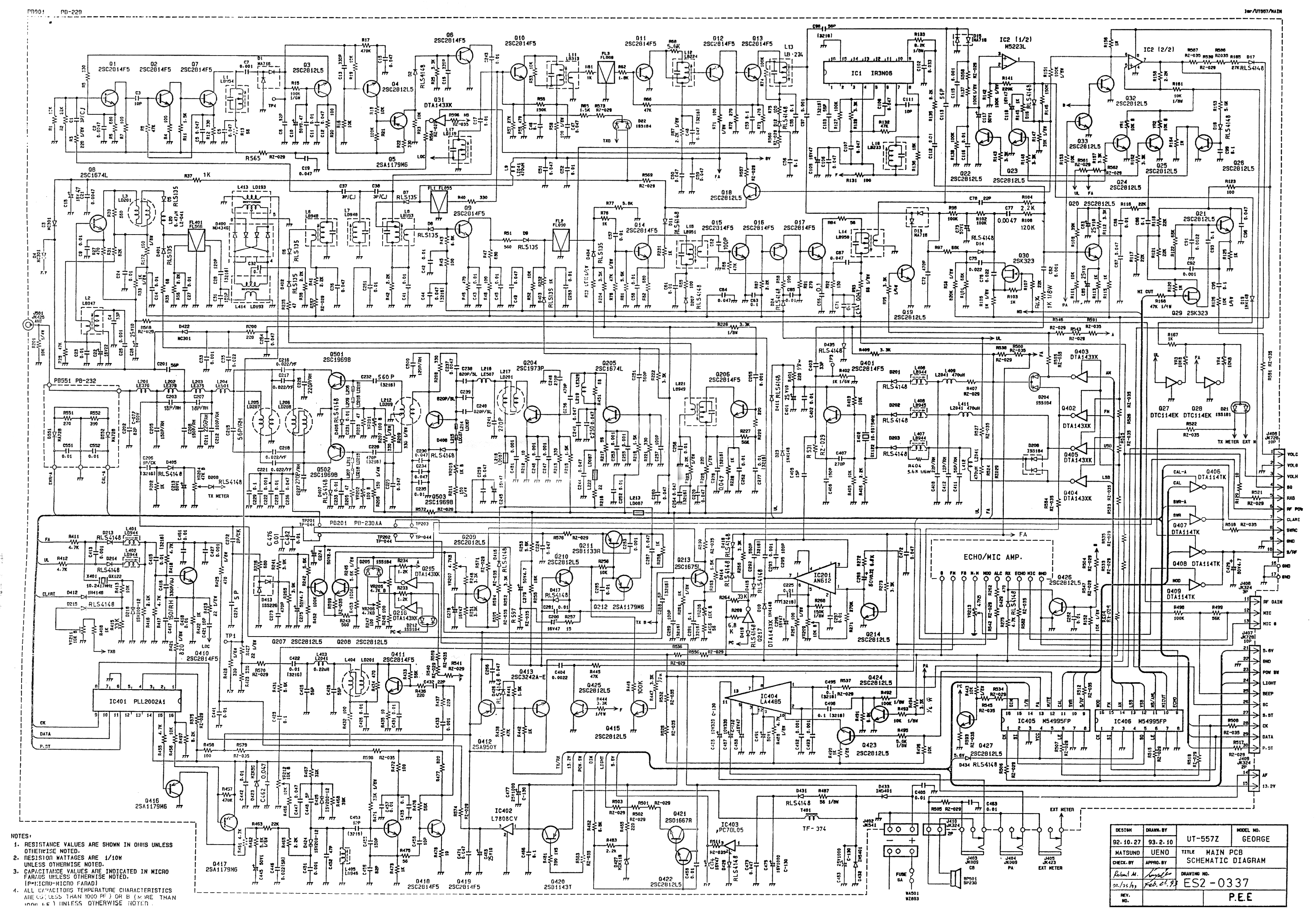

Unfortunately the circuit diagram I have for that radio is rubbish, I cannot make out most of the part numbers etc.
But the first couple of things I would do is try removing the AGC function in case that is staying turned on, this can be done by lifting R37, Q18 is the AGC control transistor.
The RF gain control goes to Q8, does the RX sensitivity change with changes to the RF gain ? if not I would be looking at that control and Q8 for correct function.
D3 and D4 are the AGC shunts to protect the front end, sometimes they get leaky and need to be replaced, so I would be looking to do that.

I've uploaded a schematic diagram that I hope is better than the one you got Defpom.
RF control button on the front does change the sensitivity at the signal. From absolutely nothing at ccw to just barely audioble at full cw.
Strong signals get through, mean very strong signals, low signals i dont get. On other radios where i have s-6 noise i don't have any s-meter reading, but at the large signals i get s-meter.
I'll try to lift R57 to see if it does anything and report back here. From there i'll look at the diodes D3 and D4.

Thanks for the diagram, that was slightly better ! the resistor to lift is R37, not 57.

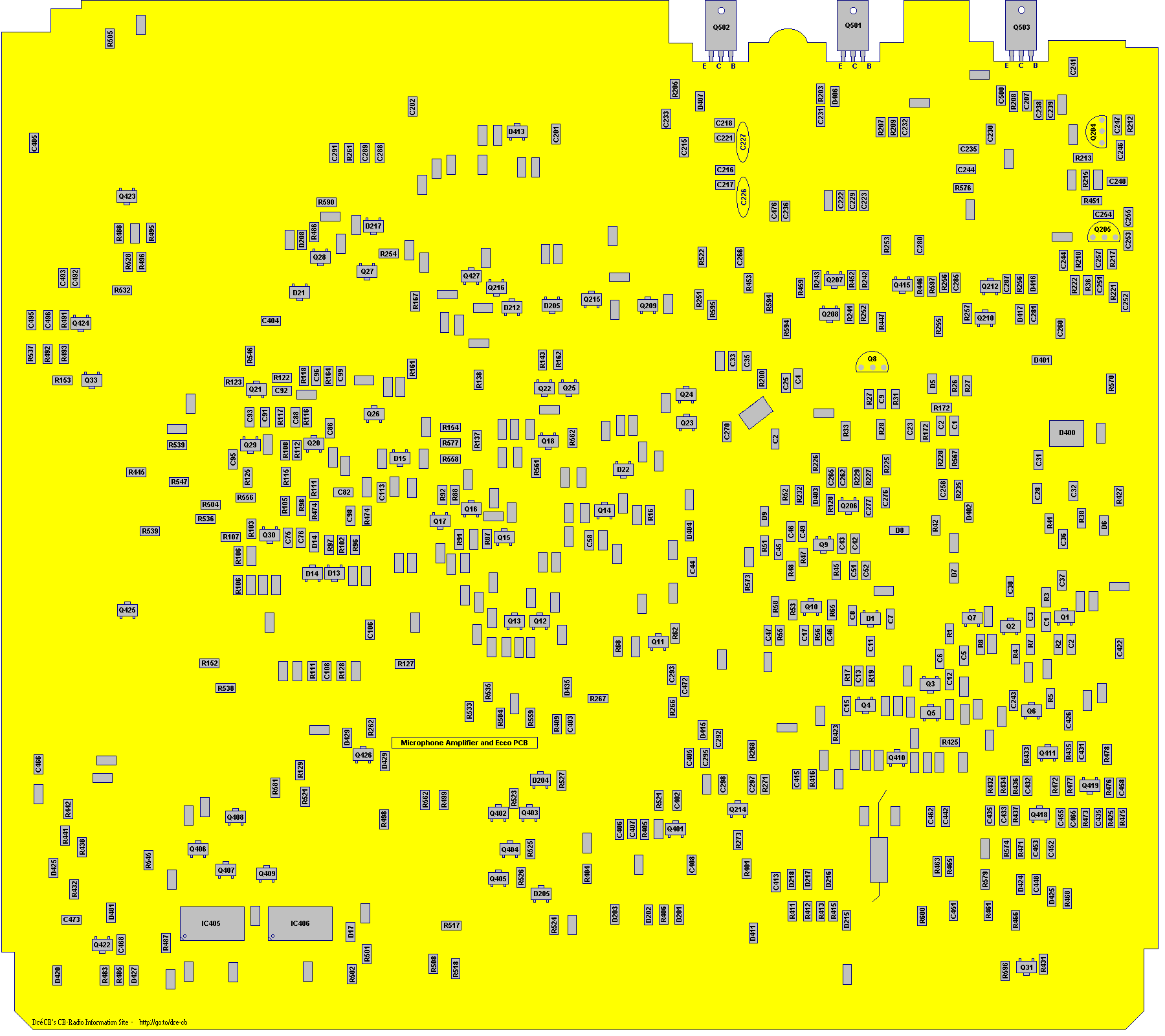

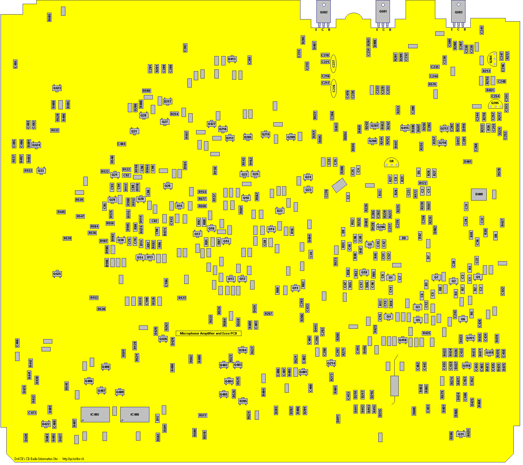

I found a mistake on the PCB layout, there are two r27 on it, one below q8 and one just to the right of it, one of those will probably be r37, see which one connects to d22/r569 and then q18
Re: Deaf President George
Thanks Scott
Will look for that tomorrow after work
I noticed that fault on the layout too, and it pussled me a bit. I've done some tracing on the pcb aswell and think that it might be a smaller project now finding that resistor.
But I'll let you know when it's done.
