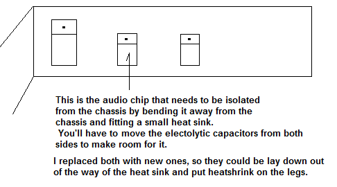

Re: Superstar 3900el low FM tx audio
The drawing should help you find it.
- Audio IC.png (10.55 KiB) Viewed 21672 times
Hi Dave
Me again the audio chip has a small heatsink behind it
i have replaced the audio chip with a new one but the problem is still there the radio is 100% when first turned on but about an hour later the audio starts to go is there any other component what will cause this also i have noticed the outside of the mic socket gets hot be very gratefull for any help
John,
I misread your problem, you are asking about the TX audio and I've given you info on the RX audio for radios with the TDA2003 audio chip, sorry.
