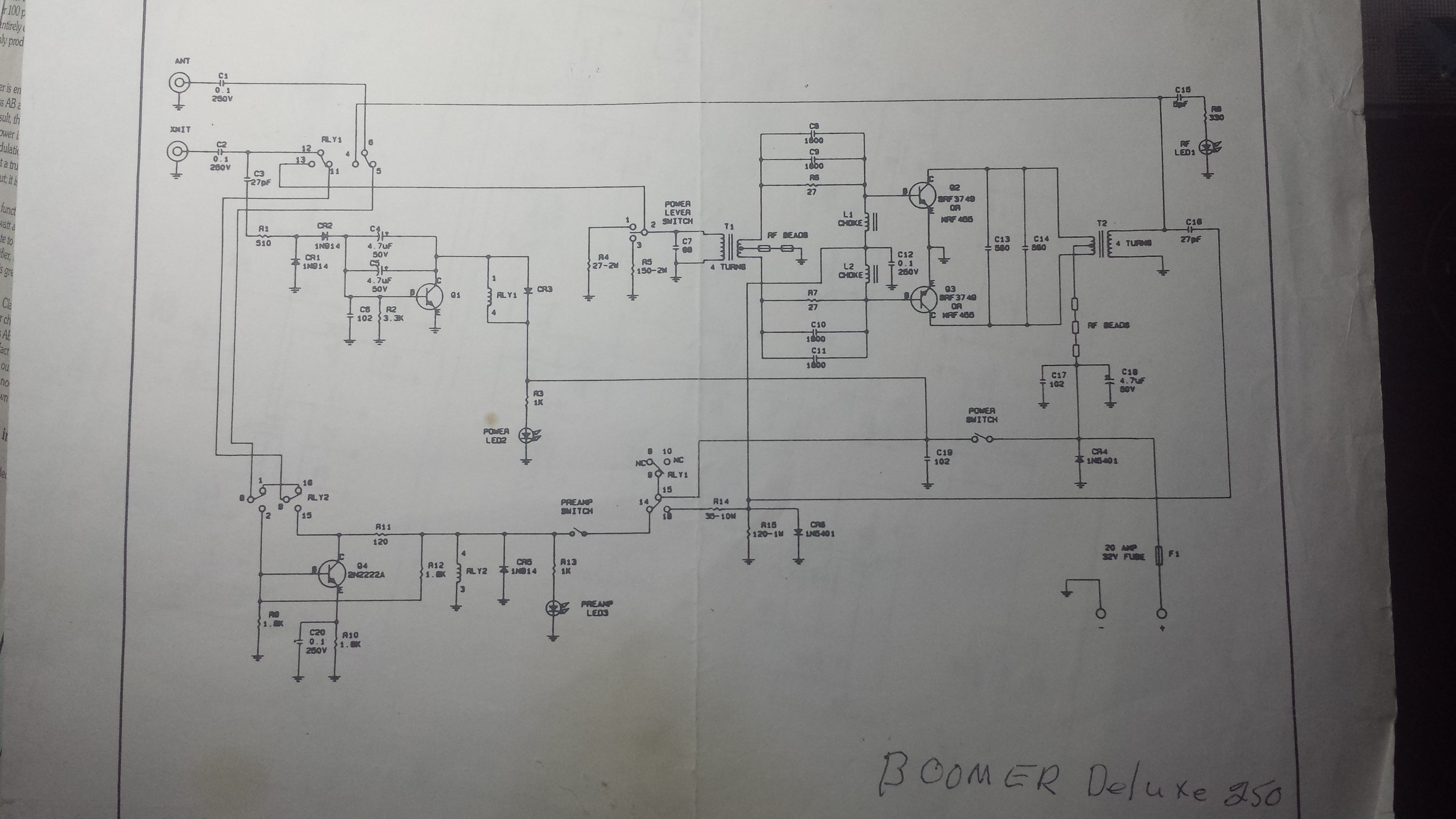

Need a schematic or diagram for the "hi med low" switching on a shooting star 225 plus. Its missing resistors and wires! clear Pix of the inside of the unit would help as well.

Got this from Delta 400 its the same and is for a lot of that type design
