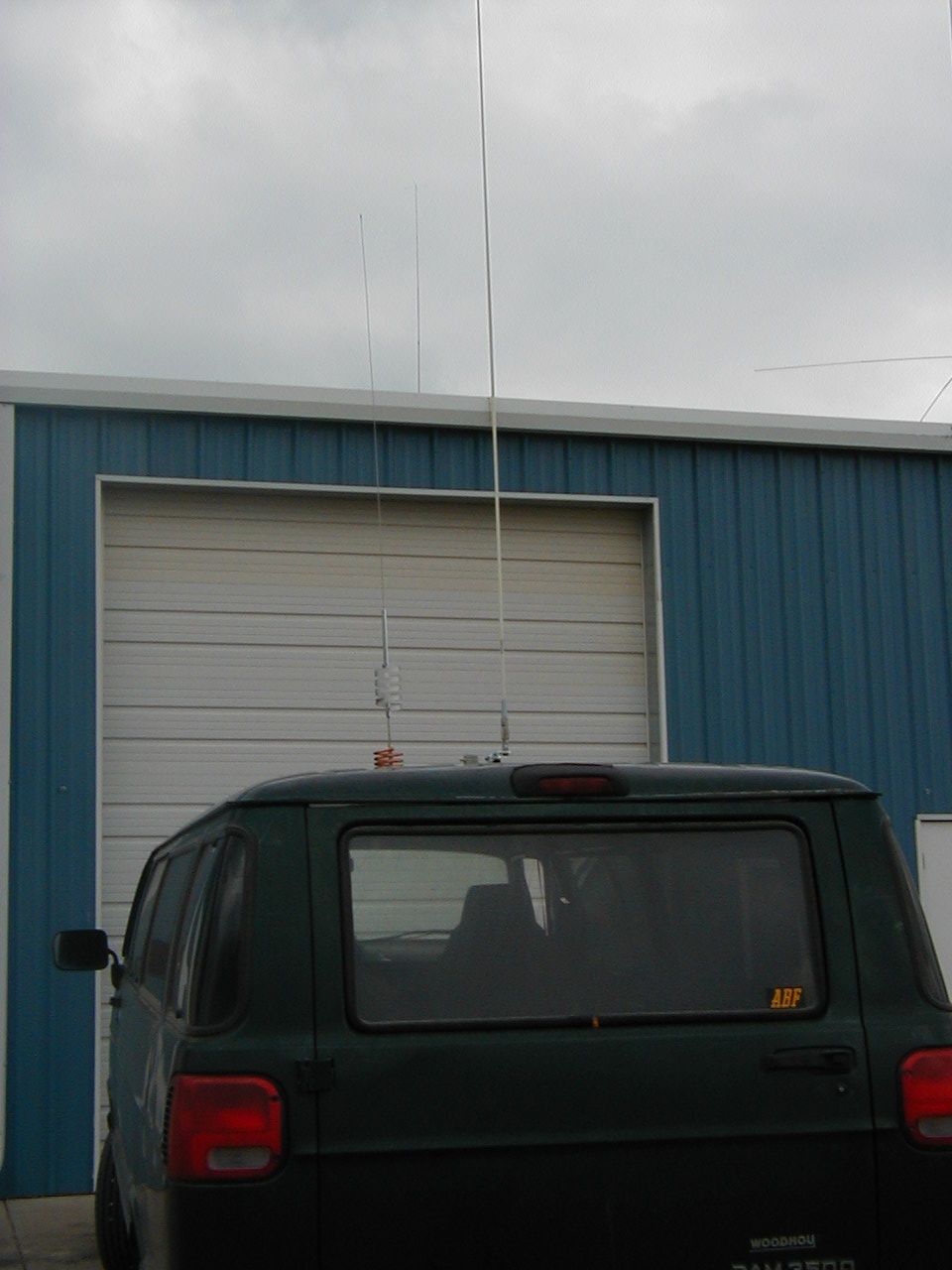

Here is a beam that works extremely well. We designed, built and installed this and the first ground wave contact we made was almost 90 miles as the crow flies. So mobile beams are not junk they work very well when properly done. The reflector is on a quick disconnect so it can be removed when traveling in town but works realy well on the highway.
Dennis
Platteview Custom Radio
