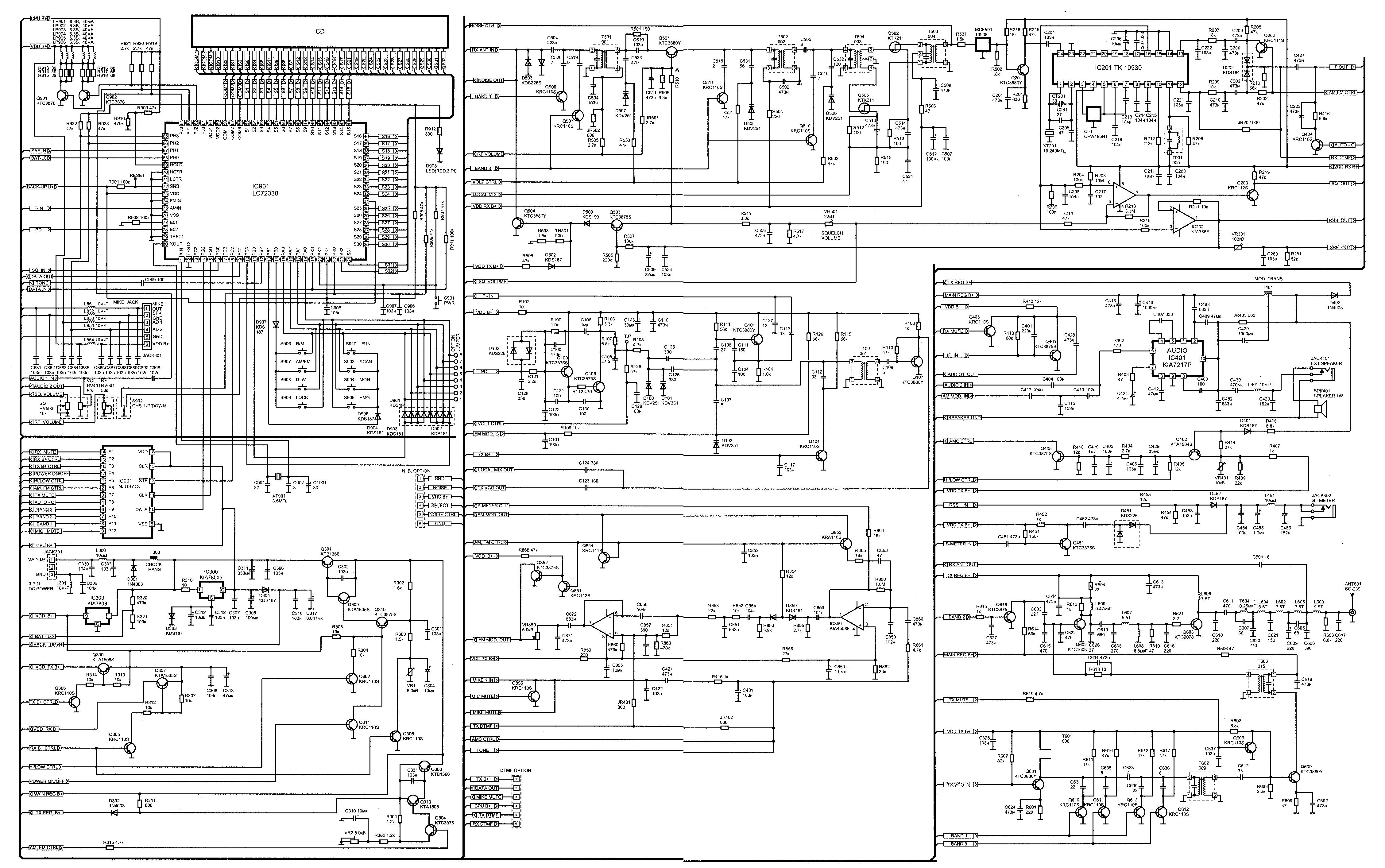

- EM-27 Schematic
- (1.7 MiB) Downloaded 194 times

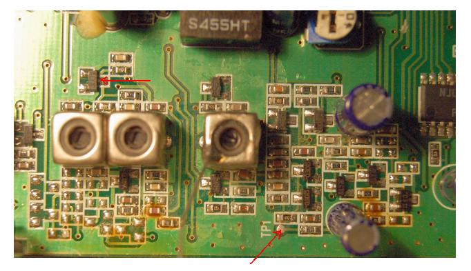

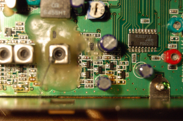

Goop now removed, the board is as in the new photo.
Does this mean that the varicaps are kippered? If so then Rick - do you have any left?

TP1 has constant 2.67V regardless of channel selectedYou can test the VCO, by checking the voltage at the junction of R107 and R108 the voltage should go up has you go from channel 1 to 40
The 2nd arrow is where I have tested this (is this the correct point?). I has constant voltage, about 45mV regardless of channel selected.if it not check the voltage at the Base of Q100 the voltage should go up has you go from channel 1 to 40.
R102 measures 9R9, so it looks fine.Also check for volts at each side of R102 it should be about 8 volts, I have had R102 go open circuit.

- Now without goop
- Maycom EM-27 PLL 2.JPG (69.04 KiB) Viewed 22508 times

John - If you google the varicap part number (KDV251S) that is on the circuit diagram you should be able to get a datasheet for it. It is from a Korean semiconductor company.
edit: here's the link http://www.datasheetcatalog.org/datashe ... 251M_S.pdf
That has the markings on. From what I can remember I think they are marked Q3 - please double check these details though as I am remembering this from about a year ago.
edit: They are certainly marked Q3.
Let Rick help you with the faultfinding process before deciding they're knackered though. Also in the pictures there looks like there is some sort of residue by one of the varicaps, thats not the wax. Check to see if that residue is conductive in any way.
