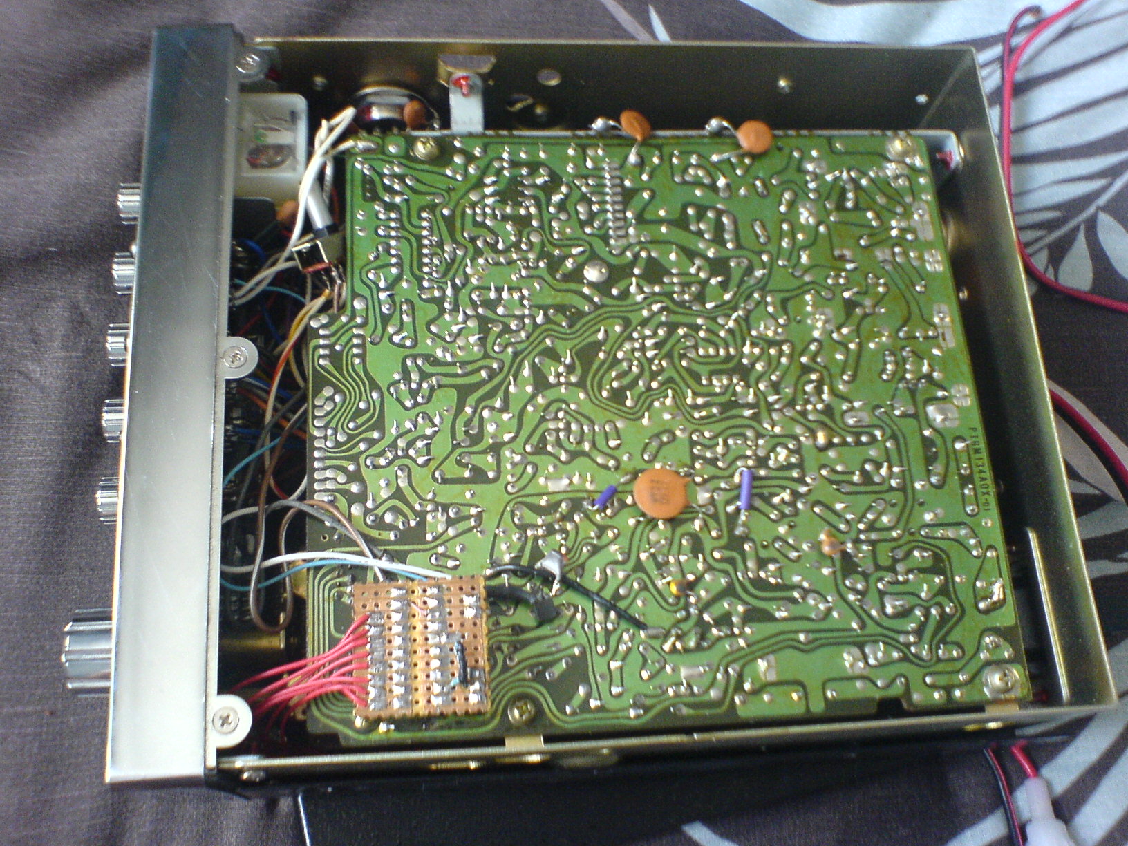

134jpg
Hope the jpg helps a mod done 2months prior xcuse the cloth shot not very pc..not my table not my cloth.. basic cop' prefboard 20pin ic skt etc. use new/old resistors legs for the linkings. 2k2 res heatshrink 2sc945 npn or equiv. all other info this site or open channel.

Thanks warhorse for all your help i got all the info from open channel with its useful pictures the only problem i have is i have wired up the switch one side to switch between uk and mid but they is 2 other wires on it that make it more or less bang on freq and cant tell where these go from the pics or diagram thats on it, could you shed any light on this or any more useful pics thanks shaun
beerbarrel134
Think the mod thats explained is a simple 2 wire job 1 to earth the other to the cap via the switch. Played with lc71 mod in the 80’s for a simple way on the mids it works very well the uniden mod is much the same but tc9106/sm512? are quite hard to get in the uk. there are other 7130/1 mods but they are like a lot of hex inverted radios where the frequencys are way off spec to the example below.

beerbarrel,re cap switch
HI dont lose faith the mod isnt voodoo instead of the basic 2wire job get a wire and place 1Wire to the circuit trace pin 1 of ic1=TA7205 if you look closely there are flowsolder over holes on this trace locate with soldering iron desolder, the solder, the trace is 13.2v. feed the wire through the loom
to the switch the other wire from the switch goes to a 2k2 resistor/red/red/red/gold. or value inbetween these values brown/black/orange/gold,10k(you have to use a resistor because the volts will zap the transistor) then to a npn transistor say 2sc945 the resistor goes to the Base junction the collector to earth and the emitter to the cap of q20 centre trace,etc? looking from the left of the transistor flat side from the front= emitter-collector-base. easy yeah''. when you flick the switch to the base current makes the transistor conduct the emitter-collector(depends on how you loook at it) to earth but unlike the cap its only on when the base has volts so its a switching transistor.
