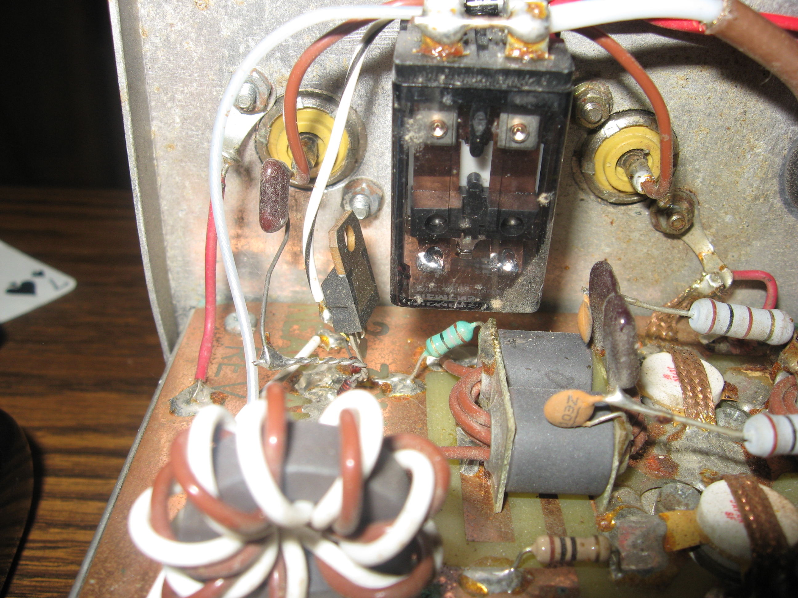

Thanks for replying really quick. We dont have a schematic but if you want i can take a picture of what it looks like where the keying relay is with surrounding components . Will this help. The cable that is being used is The gray RG8mini cable. From radio to amp. And from amp to antenna. Swr is 1 to 1.2. Barely moves on all chanels. This Box is a pirate 1.5 KD.
Here are the pics. Couldnt get to the bottom of the board to show you the trace. Its a pain to get to.......So what do you think

Ok, before we consider rebuilding the RF keyer, there are 3 thing that I would like you to do.
First replace the capacitor going to the keying circuit, its currenty a 47pf which is larger than most RF keyers, put a 15pf in its place.
Then give the transistor some bias by adding a 470-1000 ohm resistor from the emitter to base. This value is a starting point, most RF keyers use a 2n2907 small signal type, and a 470 works well in those circuits.
Take a .047uf cap and place it between the emitter and collector of the transistor.
The following is optional, but may help reduce false keying in areas with high RF, I.E...(Towers).
Try placing several small ferrite beads on the base of the transistor (between the 15pf cap and transistor/diode junction, but, if you don't have ferrite beads, a small rf choke around 10-30 uh should work also.
Let me know your results and if not satisfactory, we will redesign the RF keyer, with time tested designs that work well.

At what watt rating should be satisfactory for the Resistor, Also for the 15 pf Thanks . Im going to the shack and pick these items. Afterwards will try it in and up the towers to see what happens. Hey Thanks Tim. Appreciate you being with me on this adventure. Hahaha, Im keeping my fingers crossed. By the way if i cant get the rf beads will the rf chokes apply in the same placement as the ferrite beads? Also what is the watt rating. John.........
A half watt resistor will be ok and the 15pf cap should be at least 50 volts. Most disc caps don't have the voltage rating on them, but you should not run into any problems if you find one in your junk radios. Radio shack sells a bunch of disc caps (Catalog #: 272-801), perhaps you will find a 15pf in there. If you have a junk CB, you should be able to find everything you need.

Well, the 470 ohm resistor is a starting value and may need to be increased, 470 is a common value used with the small signal transistors (yours is a power transistor). Giving it some bias will help keep the transistor operating more stable and reliably.
The 15pf cap will not let quite as much RF get to the keyer, that is not going to change the Amplifier class. The .047 is going to help stabilize the circuit as well.
The optional ferrite beads should block some of the higher frequencies, like those picked up by nearby towers from entering the keying circuit, provided that the RF is getting in through the input line.
Many years ago, I used to homebrew amplifiers, and I have messed with all sorts of designs of RF keyers. I have experienced problems and I found out that what works is circuits that many manufacturers are still using today. Almost every amp on the market uses a similar RF keyer nowadays.
What we are trying to do is to keep stray RF from causing your keying transistor to turn on and off repeatedly.

Well The results are in.......................It worked. I suspected you were an amp builder. No more Chattering. Man that was music to my ears, Hahaha. Yoyu are the best. Went to other forums and no one could explain how to cure the symptom. Listen just wondering, I dont have my meters for checking the watts, But since there is less RF getting to the keyer because of the 15pf cap will this have a tendancy to drop your output. Or perhaps decrease your input. Or is that just to drop the RF interference. Thanks a million there tim. Ill have the meters next weekend and will be able to see if output was affected. Their across the Bay here in San Francisco. One more thing was there a reason why they placed a power transistor instead of the small signal type............................John...........
Sorry, I missed part of your question. They may have used a power transistor because it was all that was handy, or, perhaps they wanted to make sure it would withstand a very strong input. The latter don't make much sense though because its 2 driving 8, and it won't take much input to get BIG output power.
Thank you Tim for the second answering to the question. Well, I"ll tell you its a better box than before. We took her again tonight to the Highest hill in San Francisco called Twin Peaks. Its a tourist spot. Monster antennas up here that transmits big signals and rule the land. No More chattering of the relays. Just don"t understand why the Builder never added these extra features. Kind of like cutting corners. Well Tim I just cant thank you enough. Imagine if i never went up there on the hill I would of never found it out. Best to you like always. Your straight AAAAAA"s in my book there Tim........ John....
