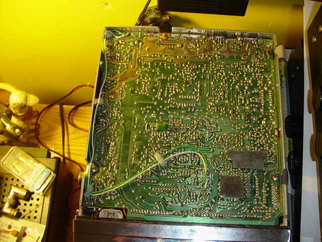

I have a 33hml that wont change power settings from lo-med-high? Stays at same wattage no matter where its switched? I posted a pic of solder side showing 2 wires do not know if factory or maybe part of problem? Thanks.

If this radio has the frequency counter plug in on the back of the radio the two wires go to it and have nothing to do with the power these were installed from factory.

No freq. counter plug on back. Very common board I never seen wires on them before? Probably some kind of mod?

Wires seem to be going to PA jack, I believe its normal for that board.
