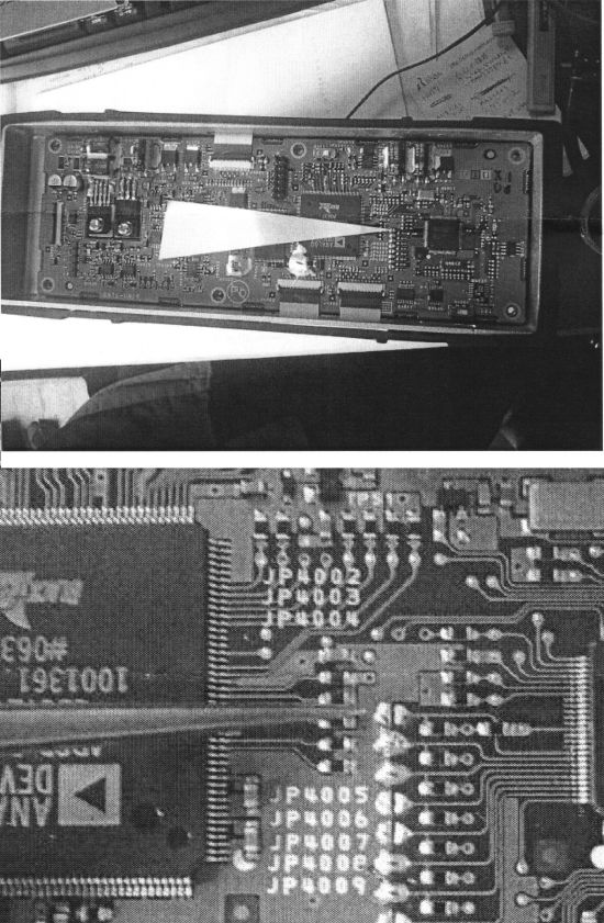

hi everyone,i just purchased a yaesu ft 450 hf transceiver with the atu built in plus 6 metres,my question is has anyone got any idea on how to mod the new yaesu ft450 ,thanks david nsw australia

Modification Procedure: Units lot 07 and above the jumper JP4002 must be removed.
Disconnect the power form the radio. Remove the front panel & the large RF shield to access the CONTROL PCB. Locate the solder jumper JP4002 as shown in the attached photos. Use professional de-solder tools and technique to remove the solder and open the contacts. Reassemble the radio and power cord.
