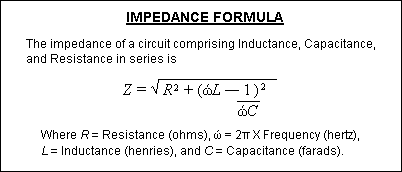

I do not like getting to technical, but there is not that easy to answer.
Impedance is not Resistance.
Impedance is more complex than resistance because of the effects on a tune circuit.
You may find this article may help you understand impedance.
http://forum.ecoustics.com/bbs/messages ... 31527.html
