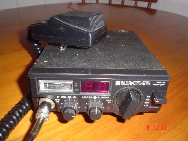

Hi!
I have got some old and broken CB radio - WAGNER from a friend of mine and would like to fix it.
I don't know much about this product (found a few pictures only)
Suzuki 88 - El tema no es vĂ¡lido o ha sido eliminado ... n-consejo/
and can't find anything else about it.
Does anyone have or can tell where can I find schematic or anything about this 27MHz CB AM/SSB WAGNER MODEL-309???
Please help!?!

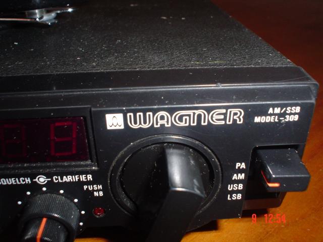

2) Verify the mode switch is OK. Find the transmit final (usually a 2SC1969) and measure the voltage on the metal tab on the top of it, while on dead key transmit (i.e. mic button in with no audio). There should be, on the 4 modes:
PA: Zero volts
AM: Between 5 and 8 volts
USB: 12 to14 volts
LSB: 12 to14 volts
If you don't get these readings, the mode switch is toast.
