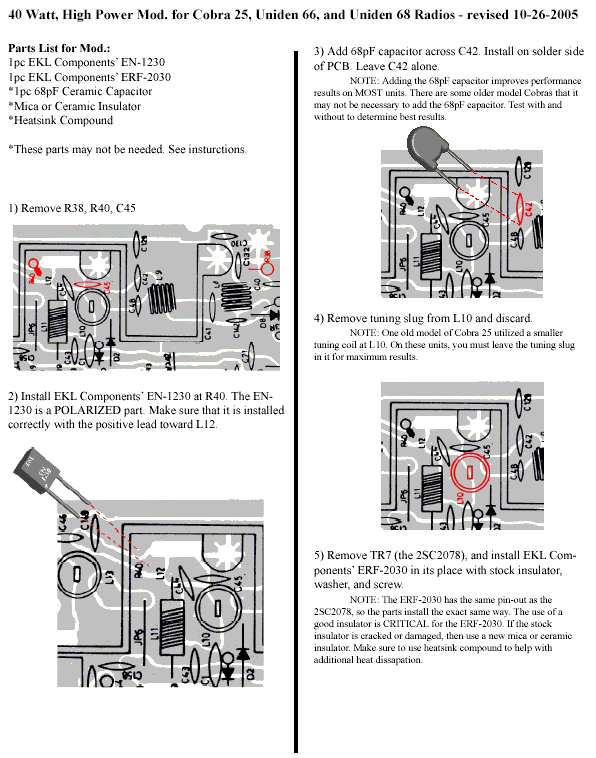

Hi guys. I've been looking around the internet for some good instructions for doing the IRF520 MOSFET mod on the cobra 25 but have not been able to find anything other than the cbtricks ERF2030 instructions. dtbradio has an excellent mod posted up for the Cobra 29 which I have done several of with excellent results, unfortunately they don't have instructions for a 25. http://www.dtbradio.com/tips.html#cobra
can anyone point me in the right direction?

IRF520 and ERF2030 are the same. Here is a cheat sheet for installation.
