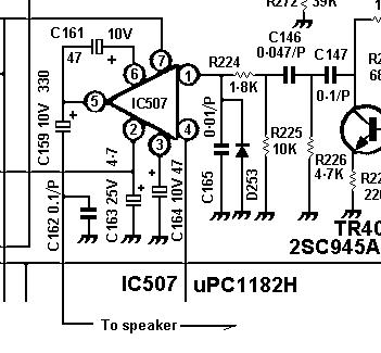

Does the audio work on PA ?.
If not then check C159, 10v @330uF and C161, 10v @47uF, better still change both for 16v capacitors at the same uF value. IC507 is the audio chip.
ST9 FDX audio.JPG (28.97 KiB) Viewed 34985 times

zodiac wrote:Does the audio work on PA ?.
Thanks very much for your help) i done those checks c159 and c161 all checks out, i done checks with muilti meter tester ,i will have to get a ic507 audio chip; it run's very hot even when i was doing the checks so there must be a short in the chip thanks again dave :)

Yes,
It's on the schematic above, UPC1182H.

zodiac wrote:Yes,
Thanks dave i should had seen that :doh: many thanks philip

These are the voltages on the audio chip pins starting at the back of the radio in FM mode.
13.5
12.3
7.0
0.9
2.11
2.9
0.9

zodiac wrote:These are the voltages on the audio chip pins starting at the back of the radio in FM mode.
13.5
12.3
7.0
0.9
2.11
2.9
0.9
i done those checks and mine does not look the same, and the sq does nothing when you turn the switch up
13.7
12.4
4.85
0.02
5.76
7.21
4.54
i think going with these checks that this output is fryed... was wondering what your opinion was dave or is it a blown part in the set
