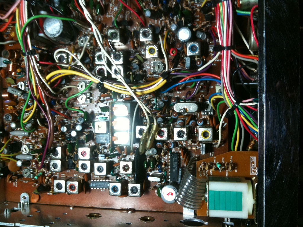

as the radio is there is a link from the top of the X3 crystal running to the top of the L22 tuning pot.where would i obtain 1 of these crystals?

Complicated lol

by The Defpom
You would still need to align the radio after the conversion to AU, not only the frequencies, but you would also need to align the TX and RX sections as well, as they will likely be tuned for best performance on NZ.
You would need a 7 digit frequency counter to correctly align the frequencies, if you do not have one you should not attempt it yourself, as you need to correctly align them with a precision of at least 20Hz (for centre clarifier on SSB), personally I tune to within 5Hz on my bench (the accuracy changes with temperature, so it is a little subjective, in a vehicle it could end up being slightly higher or lower in frequency)
The wire on X3 is there to just help the frequency stability, as the casing is then at 0V instead of floating, it does effect the frequency slightly, and also helps to reject interference form other RF sources form getting into the oscillator.
You should probably find a good radio tech, I am sure that there are some good ones around over there, ideally you should use one that is recommended by someone else, don't just go by the often "self important" garbage that some people say on CB making out that they know what they are doing, often that is not the case at all, that is why I say find someone that is recommended to reduce the chance of making a mistake.
I have some 11.325MHz crystals here if you get really stuck (would happily swap for the one in your radio now, at least I could use the 11.1125MHz)
