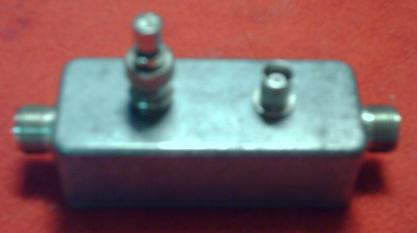

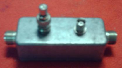

Ok, Here is the finnished "Breakout Box"
It has a second BNC connector in parralel with the first, that fits a 50ohm 1/2 watt network terminator from my old computer junk box to give 50 ohm load to scope as required.
The only problem is that I dont see any audio on scope... if I remove the 50 ohm terminator I can see tiny movements on the scope.

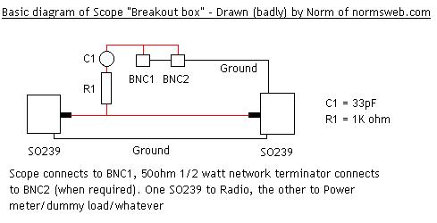

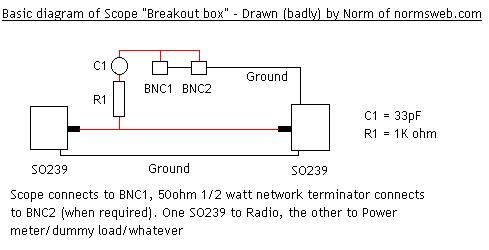

Here is the circuit I built:
I dont think I made any errors in the build... I fear that my basic scope may be just too basic for this task :cry:
However, if i connect scope directly to collector of Q9 (ptbm059) I get good audio on scope :?

First of all, if you require multiple BNC outputs, they should each have their own network (the 1K resistor, the 33p capacitor, and the 47 ohm resistor).
Otherwise, all sorts of loading and RF effects can happen.
If you have some BNC terminators, then use a "T" adaptor at the 'scope end and not inside the box:
2 x SO239 centres --- 1K resistor --- 33p capacitor ---BNC:BNC---------"T"--SCOPE INPUT--"T"---50 ohm load
i.e. "SCOPE INPUT is the centre of the T adaptor.
You should definitely have something on the scope:
10W of RF, at 50 ohms = 22 volts of RF.
The 33p cap has a "resistance" of about 150 ohms at 27 megs.
Therefore we have a voltage divider consisting of 1150 ohms / 47 ohms - this will divide our 20 volts to about 1 volt RMS, or nearly 3 volts as seen by the scope (the "peak to peak" voltage). Set the scope for 1V or 0.5V per division vertical scale, and you should see a signal. Any loading effects might mean you have to crank up the sensitivity a bit, but you should see something.
Can you see carrier (like the fat line in picture 1)?
If YES, then you need to modulate it on AM and adjust the Time/Div on the scope for something like the picture number 2.
If NO, then you have a cable, component, loading or scope issue.
First of all, substitute the scope for a counter. On a carrier, does the counter show your frequency?
If no go there either, check your cables, connectors, and components with a multimeter.
Mine work with the values given - Ive made a 4 BNC port unit (signal generator / counter / scope / spectrum analyser).
Each BNC has a separate 1K resistor / 33p capacitor, but I didn't use the 47 ohm as the test gear has either got an inbuilt 50 ohm load (scope and counter) or has T pieces with 50 ohm BNC loads (sig gen and spectrum analyser).
If it shows a freq on the counter but not on the scope, then there is some sort of loading / reactance issue - this is unlikely. In my Uni days, I used an old hand-me-down scope (rated at only 10 or 15 megs) that worked fine for viewing modulation on 27 meg AM transmitters.
You should be able to find it easily enough with a multimeter and maybe some component substitution.
Sue

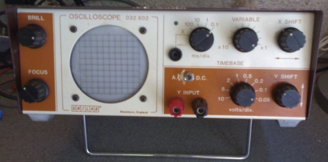

Hi Sue, I had written a lengthy reply to you, but my internet connection went up the spout and it got erased :violent2:
Here are the main points:
2nd BNC was only fitted to take terminator. Checks with FC confirm that box is working ok. Scope set to 0.05 volts/div shows no carrier. No audio on scope with 50 ohm terminator, very small audio on scope without terminator. (even using T junction at scope end)
My scope came from a science lab in a Uni, thats how i fear it may not me up to the job...its a UNILAB 032.602.

Couldn't find any usable info on that one, except it was probably made in 1960. That's old...
The only thing I could think of is that it's a valve based, transformer coupled type, only suitable for audio. What's the highest Time/Div setting? That will give a clue as to how high it's meant to go to frequency wise. When you said "basic scope" I imagined something a little more recent than that :shock:
The other possibility is that it could do this, but has lost it's performance over the years - electronics from that era have a lot of component issues 50 years on.

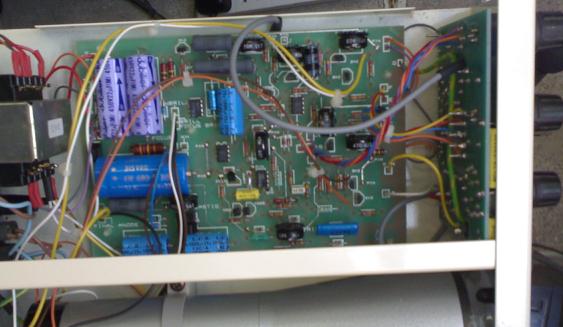

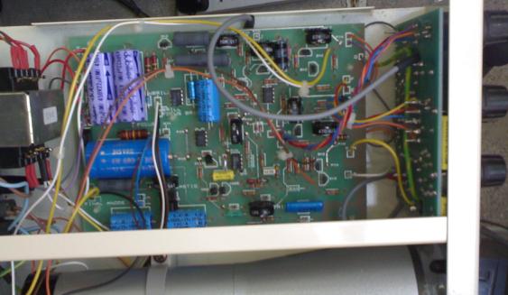

I'm pretty sure that my scope is not as old as 60's, It's transistorised and there are a few 8pin DIL chips in it:
Scope internals
Scope internals
Scope
Scope
It may be 70's-80's I dont know. I could find no info on it myself when I looked online. I think its one thats specially designed for use in schools/universitys, and probably not designed for "serious" work. It is pretty good at finding audio faults in stereo equipment, which is what I mainly use it for.
The maximum Timebase is 100ms/div
The minimum Timebase is 0.1ms/div
it also has a Timebase variable from x10 to x1
The maximum Volts/div is 10
The minimum Volts/div is 0.05
And yes, you guessed it in one! I got it cheap off ebay!!! Maybe it is time for an upgrade :-k
So it appears that my scope is just a 1 meg
That's pretty "basic" :)
With a minimum like that, its going to go nowhere near 1 meg. Your "just 1 meg" is the input impedance, not the top frequency.
The inverse of 0.1mS (1 / 0.0001 seconds) = 10Khz, and with 10 marked divisions you can show 5 of these (2 div per cycle) your limit is 50Khz (0.05 Mhz)...
It barely makes it into audio :D
It looks like mid 80's vintage to me, after looking at the pic of the internals.
There are two ways around it - you could either upgrade to something more suitable (quicker and easier, but costs $) or make up a "downconverter" to convert a 27 meg or whatever frequency signal to the 50Khz the scope can handle (very little $, requires knowledge of low level linear amps, mixers, and PCB constriction amongst others, and lots of patience / time).
Personally, I'd spend the fifty quid or so a used 20 meg unit.
