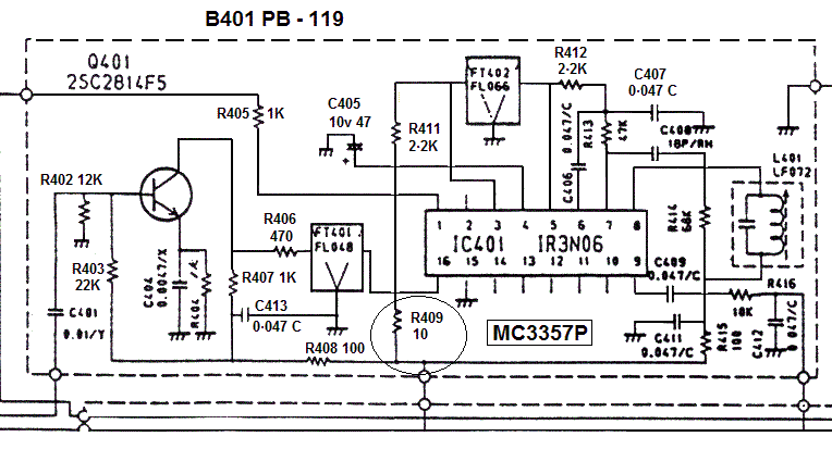

Re: President 2510 NO FM RX just white noise
This is the FM board, I've cleaed it up a bit but you can now see the resistor.
Maybe the newer radios have it mounted on the other side of the board as the diagram is for the PB119AA board.

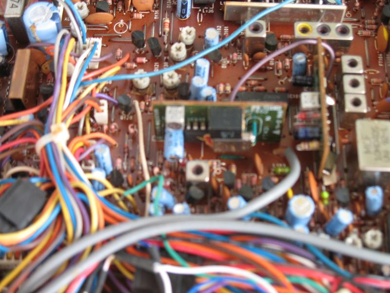

here is my fm board as you can see no resistor on it and non in the back every thing on the back side is surface mount
- fm board on my 2510
- fm board2.JPG (88.74 KiB) Viewed 19946 times

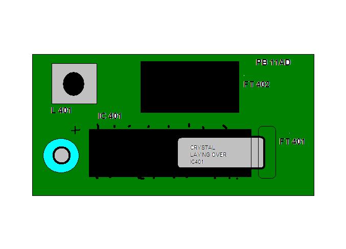

a drawing of the fm board
- ms paint of my board
- FM BOARD 2510.JPG (22.06 KiB) Viewed 31535 times
You've got a slightly different board than what I'm looking at, yours has a capacitor on the side shown and no resistor.
The board I'm looking at is the 119AA, the first board used in the radio. If you do take the board out it might be worth changing the IC for what it would cost, you never know it just might be that that's faulty.
