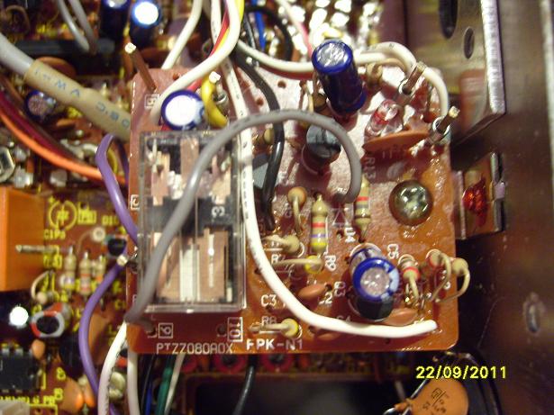

Can anyone out there shed any light on what parts/wires need to be swapped/replaced on the PTZZ080AOX board in the Tristar 777 to get the Nato 2000/Hygain 8795 type beep.
I have searched high and low and looked at various diagrams but they are either too unreadable or are not the exact diagram so the beep portion is left out.
TIA
The PTZZ080AOX as it is in the Tristar 777

The PTZZ080AOX in the Tristar 777 & Superstar 2000 can be "rearranged" slightly to get the same beep as the nato 2000 and hygain 8795, I just need to know what and where, The Hygain 8795 PTZZ080AOX diagram you can make out the slight changes but is not clear enough.

Well I managed too suss it.
For anyone thats interested
For the Tristar 777
On the PTZZ080AOX
Remove the wire that jumps from [9] to the cathode of D4
Add a 1N4148 diode in D4
Remove D3
Remove the one end of R13 [The end closest to D3] and connect the free end of R13 to ground.
Remove the pin marked [1] [this is the constant voltage from the mode switch when on CW]
The now free hole [1] connect this to a constant voltage of around 8v
Remove the pin marked [4] next to the relay [this comes from the TX pin on the mic socket]
Connect that wire [usually purple] to the pin marked [P] Theres already a pin in the hole [P] which goes to the CW socket, Leave this in place.
Remove the wire from the hole marked [6] and put this in the now vacant hole [4]
Thats it you should now have a Nato 2000/Hygain 8795 beep, The duration of the beep is a little longer than normal but changing the value of C1 22uf to a 10uf was about the best.
This should also work in the Superstar 2000
