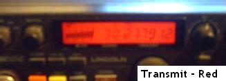

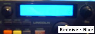

Job Done! :dance:
Now the Lincoln looks blue when in receive:
And red when in TX:
The colours are a lot deeper than shows in these pics and it looks very nice :lol:
In the end I used a subminature relay, switched by the TX line of the mic. The relay switches a Bi-Colour LED, powered from the original bulb wires through a 510 ohm resistor. I will draw (and upload) a diagram soon
