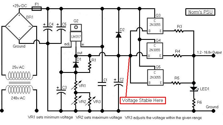

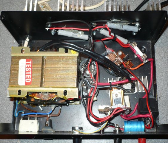

This started out as a G-Comm 13.8V 12A Power Supply. When I got it all that remained were the Transformer, 6800uf Filter Caps, 2N3055's and Load resistors. I built this circuit:
NOTE: Although this circuit works, it is not good under load...Please do not build it. Read further down the topic to find a much better regulator circuit!
BR1 = Bridge Rectifier
C4,C5 = 50v 6800uf Electrolytic
Q2 = LM317 Adjustable Voltage Regulator
D1,D2 = 1N4007
R1 = 240 Ohm
VR1,VR2 = 5k Trimmer
VR3 = 5k Pot
C3 = 35v 10uf Tantalum
C2 = 35v 4.7uf Tantalum
C1 = 0.1uf Ceramic
Q3,Q4,Q5 = 2N3055
R3,R4,R5 = 0.1 Ohm 10 Watt
I used the original Load resistors and 2N3055's and the power would drop by roughly 0.2 volts per amp drawn (13.8v became 13.2v under 3 amp load). Voltage at the base of the 2N3055's is stable (only dropping 0.01volts under a heavy load), so replaced the 2N3055's and the load resistors with new ones. Now it drops by about 0.1 volt per amp drawn (13.8v now becomes 13.5v under 3 amp load)
Can anyone see any reason for this voltage drop? or anything I can do to prevent it? If I were to pull 10 amps (theoretically) it would drop by 1 volt and thats not acceptable.

You need a better regulator circuit.
1) Regulators work by basically being a variable resistance in series with a load. That's what the '3055s are doing.
2) Emitter resistors are needed to ensure that the current is shared equally between the pass transtators.
3) Current across a resistance = heat + voltage drop.
To regulate effectively, the regulator element MUST be able to "see" all of the output resistance. In the '317, the sense point is at the output pin, and that's where it will regulate to. When you draw current, the fact you've got resistance will mean a voltage drop. That's a limitation of the circuit.
To "fix" it, you'll need a different regulator - one that takes it's "sense" input from the output terminal, and not halfway through the circuit!
One other bad point - '3055s commonly go short or leaky collector to emitter... this will feed your radio with 25 volts. Radio will fail to make a noise, and generate smoke instead.
You really should have an overvoltage protection circuit in there, especially if it's feeding expensive / not easily repaired equipment.
Do a google search for "crowbar circuit".
Hope this helps
Sue

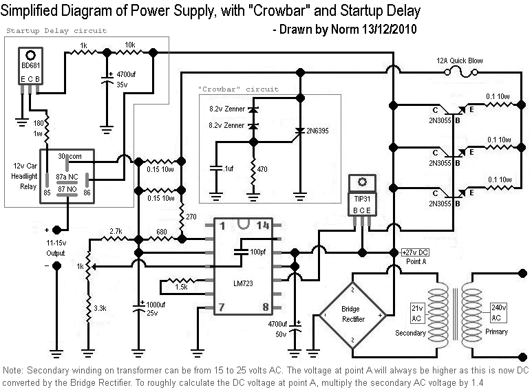

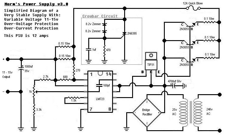

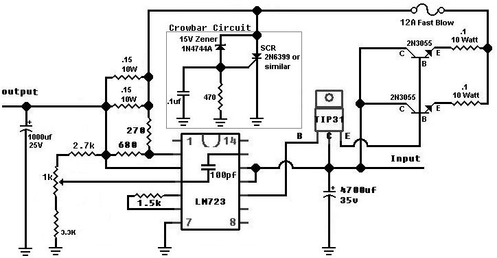

A better design (from the national semiconductor Analog devices master data book):
Regulator:
Protection circuit:
Happy soldering...
PS: If you are using this to power a transmitter, I'd add an LC filter between the top of the SCR and the output terminal (basically a heavy duty series inductor, bypassed to ground on both sides with 0.1uF capacitors) to stop RF getting into (and possibly confusing) the regulator IC.

Hi Sue, Thanks for the detailed reply. I had planned to build an over volt circuit once I had got the voltage stable.
Noting what you said about my circuit taking its "sence" from the middle of the circuit and the design of the original circuit, which does not have the 2N3055's, I note that it is R1 in my circuit that is the "sence"... it sees the voltage at the output of the LM317 and adjusts the voltage to keep it constant... So a plan comes to mind (this may be a bad idea, and maybe my brain is doing overtime), But what if I was to disconnect R1 from the output of the LM317 and connect it to the load side of the load resistors (R3,R4,R5). Then it would be senceing the output and adjust the circuit accordingly??? -or maybe not!

No, that won't work. The '317 uses a fixed voltage between ADJ and OUT (1.25V from memory, haven't used one in ages) and the 0.7V B-E voltage needed by the 3055s will muck this up big time.
You need a regulator that is designed to be used with pass transistors - the 317 is NOT designed to do this, it has been made as a standalone regulator.
Keep the 317 for another project where you only need 1.5 amps. Buy a '723 IC (they cost about a dollar here in Oz) and a smaller pass transistor (a common TIP31x works great) and build the circuit shown.
You can re-use your 2N3055s and their big emitter resistors.
Total cost would be under $5, or under $10 if you include the overvoltage protection.
Sue

Ok, LM723 and TIP31 ordered... lets hope I build it properly and it works right!
Is there any alternatives to the SCR and Zenner diode on the Over-Volt protection circuit? I'm having trouble locating 2N6399 and 1N4744A. What about if I put 3 x 5.1v Zenners in series...would that work instead of the 1N4744A?
That will work OK, as long as you connect them correctly (all the same way, i.e. AK-AK-AK).
The SCR is not critical either - anything that can handle 10 to 15 amps for a few milliseconds (the time it takes for the fuse to blow) will be OK.
You shouldn't have any trouble getting them from the likes of RS components, Farnell, or most other "real" suppliers (i.e. not Tandy/Radioshack or your local TV / Hifi shop)
In the UK: Farnell part codes are as follows: 1459025 (cost = 146p) for the SCR, and 1612368 (cost = 4p) for the zener. It'll cost you more for postage :lol:

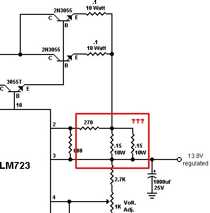

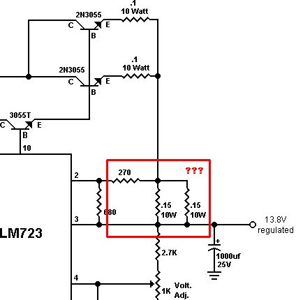

Hi Sue, I'm getting close to building the circuit now and have been studying the schematic for a while now. There are a couple of things I cant work out about the circuit:
I cant work out what the 270 ohm resistor and the .15 ohm resistors do? It seems to me that the 270 ohm with the .15 ohm's are basically parralleling the 680 ohm (current limiting) resistor?
and with the 2N3055's each having their own load resistor (.1 ohm 10 watt) are the .15 ohm resistors needed? I'm only thinking that the less resistance in the output path is better???
I've worked out what all the other components do but cant figure out what these three do.

***** Download the full datasheet from the National website if you haven't done so already. *****
These form an over-current sensing circuit - as current is drawn from the circuit, a voltage appears across the two 0.15 ohm resistors, directly proportional to the current drawn.
This voltage us divided by the 270 / 680 ohm resistors, and then used to reduce the drive to the pass resistors if the output exceeds a certain value (about 12 amps with the values shown).
This in turn protects the supply from accidental overloads such as short circuit wiring or trying to run a 500 watt amp from it :)
The only places resistance is critical:
1) Between the bottom of the 0.15 ohm / top of the 2.7K resistors, and the output terminal.
The IC cannot sense voltage drop there, so this needs to be a thick, heavy wire.
2) Between the negative of the main filter cap and the negative output terminal.
Again, the IC cannot sense voltage drop there, so this also needs to be a thick, heavy wire.
Voltage drop elsewhere - even several volts - can be ignored. It will be sensed at the top of the 2.7K resistor and pin 10 will increase its output to exactly compensate.
You just need to make sure that the low ohm resistances can handle the power (V squared over R, etc) and that you have enough voltage to spare at pins 11+12 and the collectors.

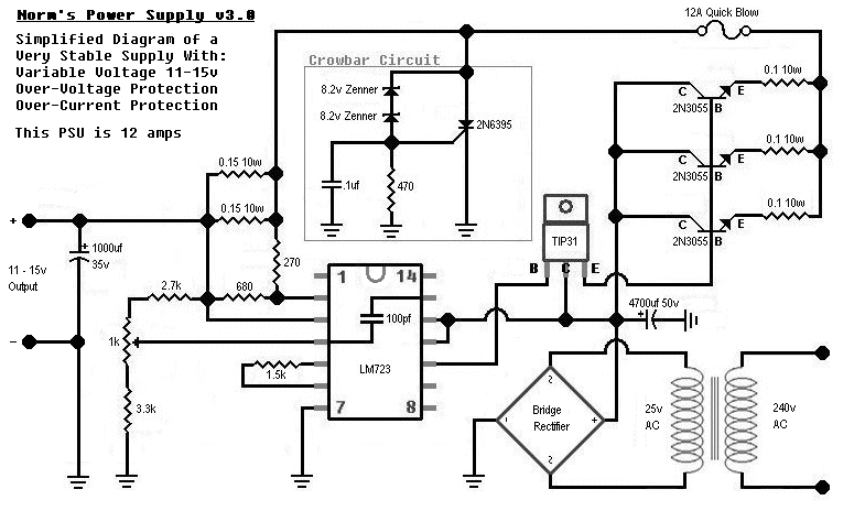

Hi Sue, Thanks again for your detailed info... I'm certainly learning a lot while building this power supply.
I am planning to make this power supply the best it can be, so after I've built the new regulator and the over-volt circuit, I will look into some kinda thermal shutdown circuit to add to it.

Regulator and Crowbar circuit built and power supply working well :dance: only dropping by 0.04 volts maximum under heavy load :D
I have one slight issue though; if a load is connected whilst the power supply is turned on the fuse blows... if the crowbar circuit is disconnected this does not happen (the fuse is inline at all times). if the power supply is turned off and the load connected then there is no problem at all, increase/decrease in load (eg. Tx/Rx) is fine. It seems that the crowbar circuit is spiking if a load is connected while the supply is on. Is there anything I can do to stop this from happening? (most older radios turn the power on and off by cutting the power line, which would probably cause the fuse to blow too -I have not tested for that though)
Here is the circuit I built:
(*cannot get pic to display on forum*)
I have 3 2N3055's and load resistors instead of 2 (forgot to add the extra one to the diagram)
EDIT: I have been doing some research into this and have noted that some crowbar circuits have an extra capacitor across A-K on the SCR to reduce false triggering. Some use 100n ceramic capacitor and others I've seen use 47uf 25v electrolytic... but which is best? or maybe I'll just add both! :wink:
There are two possibilities - both related to charging time for the capacitors. These need time to settle when a circuit is powered on.
1) The regulator is letting through a brief spike of high voltage when you first turn it on, and the crowbar is actually doing its job. The spike is being decoupled (filtered out) in the radio be the DC input choke + capacitor combo and therefore the radio doesn't get damaged. A different radio with lesser DC filtering might not be so lucky.
2) The crowbar itself (specifically the 0.1uF cap) might need a few milliseconds to settle, and is falsely triggering.
Yes, I've seen that, mainly on supplies that are powering inductive loads such as solenoids. These loads can generate a "back emf" voltage (google it, including the quote marks, if you don't know what it means) that can cause false crowbar triggering.
Experiment by all means, but it probably won't help you.
It's generally considered bad to connect a load before a supply has settled down. PC power supplies, for example, have a "power good" wire that changes state only when the supply has settled. Until this line changes state, the PC will NOT attempt to boot up. All modern electronics works this way - you'll notice that your mobile phone, DVD player, computer monitor, etc have a delay when they are first turned on to when they are fully functional.
A start up delay is easily implemented. You'll need a heavy duty relay (those 1" cube car headlight types are great) , a 10K resistor, a 1K resistor, a 10 volt (or higher) 4700uF cap, a 1A NPN darlington like a BD681 (lots to choose from), and a diode like a 1N4004.
The normally-open relay contacts go in series with the output terminal of the supply - this must be the LAST thing before it connects to the load.
The 25V goes to the 10K, then a 1K, then the base of the darlington. Collector to -ve of coil, and +ve output terminal goes to the other side of the coil.
Emitter of darlington goes to ground.
Diode connects to the darlington - anode to emitter, cathode (the marked end) to collector.
The capacitor connects between ground and the 10K / 1K resistor join point.
What does this do? The cap delays the buildup of voltage at the 1K and therefore prevents the relay from turning on (and connecting the load) until the supply has had time to settle.
The values shown should delay it for a second or so, which should be plenty. To change the time, alter the 10K resistor or the capacitor values.
If you buy a modern supply, you'll find this already done for you (although with MOSFETs instead of relays).

Here is the full Circuit Diagram of the completed 12A PSU that I built:
Norms PSU V3
Norms PSU V3
It is a very stable supply, adjustable from 11 to 15 volts and has over voltage and over current protection.
The "crowbar" over voltage protection is set at 16.4 (by the two 8.2v zenners) because when its set at 15v it is too near 13.8v and it will trip falsely when loads are connected.
If you are thinking about building or replacing the blown guts of a power supply, you should give this one a try...
Re: Power Supply - Voltage drop under load
Posted: Saturday 4th Dec 2010, 1:12
by lbcomms
If you can (i.e. you are buying a new transformer, or using one with multiple secondary taps), drop the secondary voltage. The pass transistors have to convert the excess to heat to do their job.
25V AC x 1.4 = 35V at the collectors.
At 12A there is 1.2V across the 0.1 ohm resistors, therefore 15V at the emitters.
Volts across the pass = 20V (35 - 15).
Virtual resistance = 1.6667 ohms (20V / 12A)
Power dissipated by the pass = 240 watts (V squared over R, or alternately current squared multiplied by R).
That's about as much heat (you typical halogen is 50% efficient) as 14 automotive high beam bulbs !
Dropping the secondary to 15V gives you:
15V AC x 1.4 = 21V at the collectors.
Volts across the pass = 6V (21 - 15).
Virtual resistance = 0.5 ohms (20V / 12A)
Power dissipated by the pass = 70 watts (V squared over R, or alternately current squared multiplied by R).
70 watts is still pretty high, but it's 3.5 times lower than 240W.
Can't go too much lower though, you need at least 3 to 4 volts to maintain regulation.
Unless you go for a switchmode design, but that's another story :-)
With the pass dissipation lower, as well as saving power and unwanted heat, you'll be able to get away with a smaller heatsink . You'll also be able to use higher uF value electrolytics (say 10,000uF/25V at the rectifier, and 4700/16V at the output terminal) which improves transient performance of the supply, important for SSB use.
Apart from that minor point: - well done!.

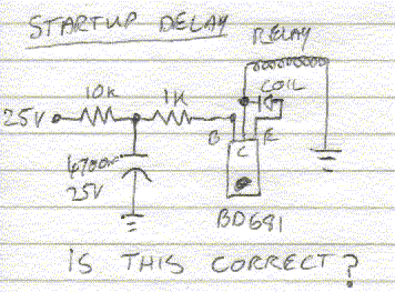

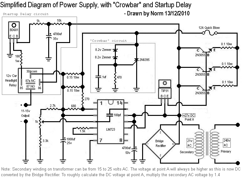

EDIT: I have started to gather parts to build startup delay circuit, but a am a little confused by this:
I have drawn this diagram of what i think is correct... can you confirm this?
Unfortunately, I can't :) There are two errors:
1) The emitter of the transistor needs to be grounded
2) The other side of the coil (on the right side of your drawing) goes to +12V, assuming you are using a 12V relay).
Drawing (not showing the base part which is correct):
If you are using a 12V relay you'll need a dropper resistor. For 25V, this will be roughly equal to the coil resistance.
Use ohms law to calculate this and the power level needed.
Example for a 12V, 200 ohm relay operating at 24V:
200 ohms: nearest standard value down = 180 ohms.
Power is (V x V) divided by R.
12 x 12 = 144.
144 divided by 180 = 0.8 watts.
Therefore, use a 180 ohm 1 watt resistor.
One of the contacts goes to the output of the regulator.
The other contact goes to the output terminal.
If there are more than one set of contacts, wire them in parallel to minimise the resistance.
Enjoy...

Unfortunately, I can't There are two errors:
I thought my diagram was incorrect as the emitter had no connetion (except to the diode). Thanks for clearing that up for me!
Again I re-confirm my muppet status!!! I have just ordered a new 12v relay... Had I thought, I could have ordered a 24v one :roll: nevermind!
The Relay I ordered has only one set of contacts, but I made sure to order a heavy duty 30 amp one, so it won't get stressed if I pull a heavy load off the supply, and I plan to fit the relay as close as possible to the output terminals of the supply, so it should be fine

I am happy to announce that the power supply is finally done! :dance: The Crowbar set at 16.4v works perfectly. The Startup Delay circuit as per diagram gives just over 2 seconds delay, which is fine.
Here is the diagram (corrected) (& simplified):
Psu v4 Diag - corrected and now modified
And here is a photo of the finnished supply:
Its quite untidy I know. :( I would have liked to make it neater, but with adding stuff, moving stuff and changing stuff to get it working good its ended up a bit untidy. That doesn't really matter though because it works very well now, only dropping by 0.02 volts with a 4 amp load... Thats better than my Zetagi power supply :shock:
I thought to keep the wires to and from the relay contacts as short as possible, so I soldered the NO contact of the relay directly to the output terminal. Thats how the relay is at a funny angle... also note my love of hot glue gun glue to secure things in place (its very handy for that :roll: )
If I was to build this circuit again, I would probably incorperate all three circuits (delay, crowbar and reg) into one board and that would make it neater, although keeping the three circuits seperate will make it easier to track a fault if it ever goes wrong.
The only addition I'm gonna add shortly is a common cathode bi-colour LED, connected to NO and NC of the relay and ground via 1k resistor... It will come on red when power supply is turned on then go green when the startup delay kicks in.
I plan to put a full story of this supply, what it started out like, and all the different stages it took to get to this state up on my own website soon. (I'll edit this post with link when i finally finnish and upload that)
I hope others can benefit from this topic, as I have, and everyone can build great power supplies in the future. Thanks to Sue for all your help!
Posted: Tuesday 14th Dec 2010, 0:50
by lbcomms
Good to see it up and running... only 2 small issues:
- The delay switching transistor is a BD681, not an 861
- The delay cap should be 35V, not 25.
When it's lightly loaded, the 25V will go close to 30 to 32V - although the 10K/1K will form a divider, limiting the voltage, it's generally considered bad design practice.
If the 1K, base, or emitter or their wiring ever goes open, result = messy explosion inside power supply :o
That stuff causes no end of grief here. Had one at the end of last summer - in a cheapie Chinese UHF set, they has used that stuff to hold some wiring in place.
Nice hot day, inside nice hot car, glue melted and dribbled into the internal speaker between the cone and magnet. Audio dropped from several watts to several milliwatts...
I've lost count of the number of pots and switches I've had to replace because of that stuff!
Posted: Tuesday 14th Dec 2010, 4:14
by Warf135
Well spotted! There goes my dyslexia again... The cap I used was a 35v one, so I dont know why I put 25v on the diagram :doh:
with all things working correctly there is 10v at the cap. (I have corrected and uploaded the diagram again)
The hot glue gun glue I use melts at around 315c from what I've been reading. Thankfully the temprature over here doesn't get that hot, so it should be ok in my supply...
I was gonna use it to fix the thermal fuse to the transformer, but just in time remembered and stopped.. thats when I looked up the temprature of the glue gun. I ended up using an epoxy resin type glue to hold the thermal fuse in place. It maybe that the chinese factorys use "cool melt" glue guns which melt at a lot lower temprature

by zodiac
Norm,
On your diagram you show the output of the transformer as being 25VAC, is that correct ?.
Posted: Wednesday 15th Dec 2010, 13:33
by Warf135
Yes that is correct, the transformer does 27v with no load and 21v under load, so I put the average voltage of 25v on the diagram... I am thinking of updating the diagram and putting 15v - 25v on the transformer output, instead of 25v, so that anyone wanting to build it wont do their heads in searching for a 25v one if they have one in the 15-25v range.
As Sue states earlier in the topic, the lower the voltage the better as this will mean less heat generated at pass transistors. My 25v Transformer was already in the power supply case and it is (was) a very basic G-comm 12a power supply, which from what i can tell, were a pile of rubbish... now its a great little supply, i just need to put some stickers over the G-comm logo :lol:
Posted: Thursday 16th Dec 2010, 4:56
by zodiac
Norm,
I would put a note in to explain that the secondary winding voltage is 15V AC before connection to the rectifier and capacitors with 25V DC after connection to both.
That should make it a lot easier to follow for those that have never done it before, it confused me the first time I built a PSU.
Posted: Thursday 16th Dec 2010, 8:07
by Warf135
Hi Dave, Thanks for your input. I have now modified the diagram and re-uploaded it. While altering the diag, I found an error myself. The main filter cap was listed as 4700uf 25v when that should have read 4700uf 50v. That has now been corrected too.
Please re-view it and come back to me with any more suggestions you may have.
Edit:
Here is a diagram of the startup delay on its own if anyone wants to add it to a supply they already have:
Startup delay circuit
