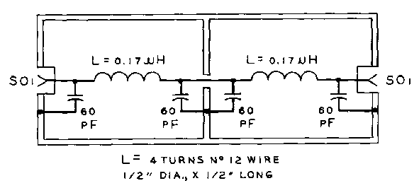

Lowpass Filter
This page shows the circuit diagram for a Lowpass Filter
This is for use on the 6 Meter band ! (not CB)
This also shows some of the constuction information.
lowpass filter 6 meter
If you build this unit and like it please email me !
