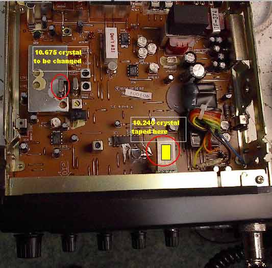

•  Locate the 10.240MHz crystal taped on the ribbon cable going to the radio front panel and retrieve same.
•  Locate the 10.695MHz ? (picture shows it as 10.675MHz) crystal sticking out of the PLL block. Unplug this crystal and replace with the 10.240mhz crystal.
•  Now solder a wire from the can of the crystal to the metal shield next to it. This way, it will never fall out of the socket.
•  Now turn the radio over and look right behind and under the edge of the faceplate kinda in the middle. There you will find a group of resistors and a couple capacitors.
•  Using the picture as a guide, locate the resistor R143 and carefully remove it.
•  You will now have coverage from 25.615 to 28.755.
