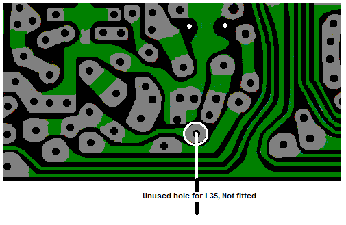

Now for the 4k7 VR. It states connect to "wiper of course tune" Where should this be connected to? Also the radio is slightly off-frequency should i put it back on frequency before adjusing the 4.7k VR if so how do i go about that?

Connect a wire from the 4.7k variable resistor to the unused hole for L35 at the front of the board, this leads to the centre of the KC shift. Connect another wire to 0v Grnd back to one of the other pins at the VR and adjust the VR for the UK off set.

I have Wired it up as per follows. L35 - centre pin on switch - top in on switch to middle leg of 4k7 VR - right leg of 4k7 VR soldered to can L15.
When i try to adjust the frequency on ch1 I can only get it to go as high as 27.60049 instead of 27.60125 with VR turned anti-clockwise. When turned fully clockwise i get 27.59307.
I have check that corse tune is in the centre position and KC shift is off
Any ideas where i'm going wrong?

From what you've said it would appear to be wired correct.
The coarse fine tune should both be at the 12 o'clock position when making the adjustment to the added 4.7k VR.
You did say that the radio was off frequency and maybe that's the reason why it won't tune in but if you look at the maths you've given there's only 0.00742 of movement from one end to the other, it should have about 4 to 5KC's on the 4.7k VR. So something is not right and even with the radio off frequency it would still move a lot more than it is.
Check the wire you fitted in the empty hole for L35 and follow the track to the left turn the radio over and you should see the screen print above the wire that's in that hole, it has (M) above the wire and COSE below it.
The wire that's in there goes direct to the centre pin of the coarse tune and saves you the trouble of removing the front of the radio to take the control out to fit the wire on.
