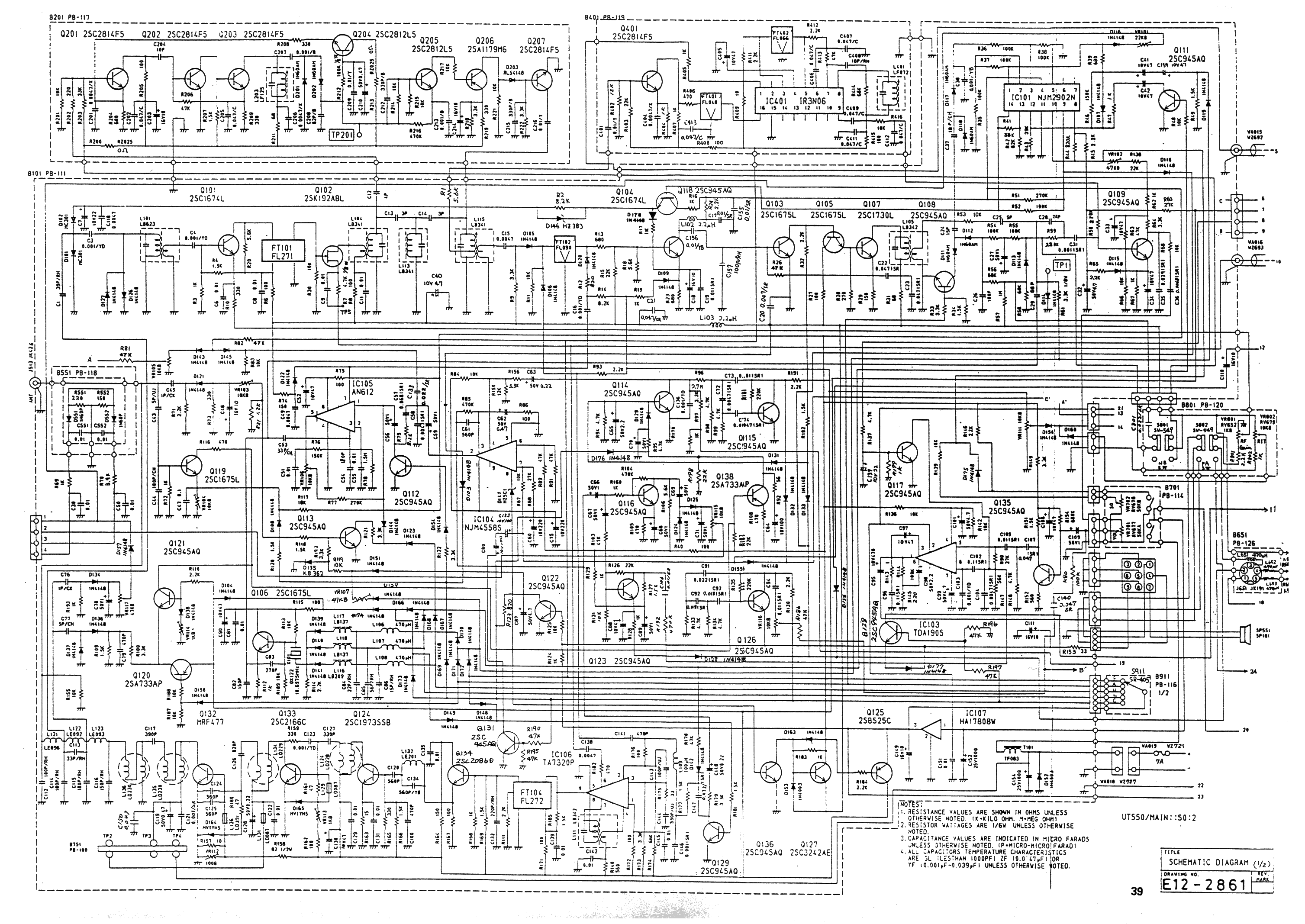

Here is better quality schematic for HR2510 (lincoln):
(581.54 KiB) Downloaded 306 times

Thankyou for the schmatics.......there grrrrrreat =D> :D

UPDATE I've just looked at the schematic and the speaker should connect to ground as it is, but the positive end of the speaker should be going to pin 7 on the 9 pin mini-molex accessory plug on the lincoln. This is then linked to pin 1 on the mini-molex connector by a loopback plug. if your radio does not have the loopback plug on the back solder the speaker wire direct to pin one on the mini-molex.
From pin 1 on the mini-molex the speaker wire should then go to the PA switch, and only after all that should it then head towards the Amp chip (IC103 - TDA1905)... so if your lincoln has a wire going direct to a chip, its definately wrong :roll:

That wire is definately on the wrong place, and thats why your getting no sound from the speaker. The speaker should not connect anywhere near that chip. I could not locate that chip on the schematic, but the datasheet for it states its some type of processor and not an amp chip.
Remove the wire from there and connect it to pin 7 on the mini molex plug at the back of the radio and see if you get sound.
